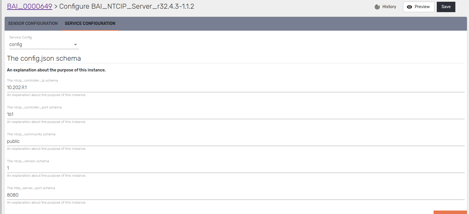

The Sighthound NTCIP Server application is the service on the device which manages communication between the device and the NTCIP traffic controller. Opening the configuration, we can specify the IP address and port of the NTCIP traffic controller. Make sure to configure the http_server_port to 8080 to match the previous FolderWatcher configuration endpoint of http://bai-ntcip-server.docker:8080/pedcall/
Saving this configuration, our device will now be modifying the specified MIB/Phase Control Bits on the traffic controller located at 10.202.9.1:161 on PRESENCE_SENSOR_1 entry and exit events.
